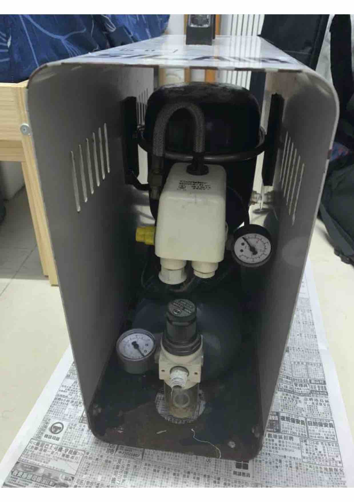

SIL AIR 15D ¤Jªo°ÝÃD
³¡SIL AIR 15d«Y§Ú¦Ñ¨§¥H«e¶R¾¤¼QµeûH
²Ó­Ó嗰®É¥H¬°«Ydµo¹q¾÷¤§ÃþûH³¥
ªñ±Æ·Q¼Q¶î¼Ò«¬¥ýª¾«Y®ð¬¦¾¤
¤Wºô¬d´N¸Üe°¦¬¦­n¤Jªo¥ý¥Î±o
¦ý«Y§Ú§¹¥þ­øª¾¹D«YÃä­ÓÁK¤J
°Ý¦Ñ¨§Ê\¤S¸Ü­ø°O±o

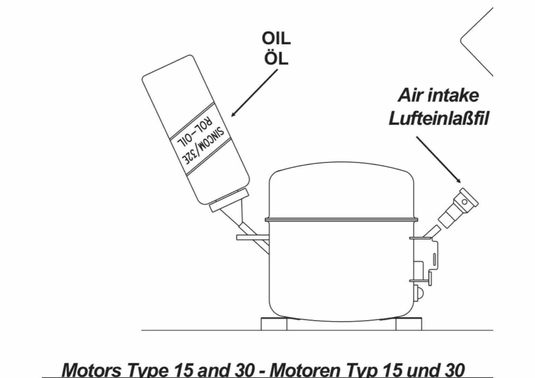

Ú»¥ªºô¤Wªº説©ú®Ñ
´N¸Üadd the oil through the side pipe (for motors type 15 and 30) ¦P NEVER PERFORM THE OIL FILLING THROUGH THE SIDE PIPE, POSITIONED CLOSE TO THE ELECTRICAL BOARD
¦ý«Y§Úµoı­Ó¬¦¦P´T¹Ï¦³啲­ø¦P
·d¨ì§Ú¦nconfuse §Ú¤SÅå¥[¿ùÁK ¾ãÃa
©Ò¥H·Q°Ýúï­n«YÃä¨ì¤J

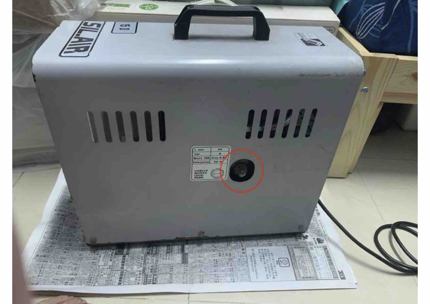

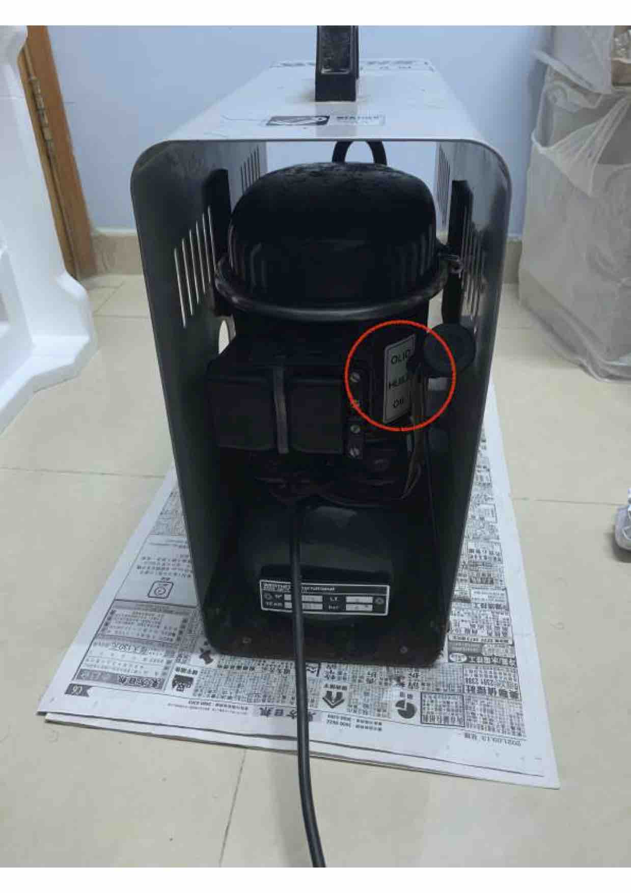

µoªí©ó 2021-10-7 10:17 PM  ¸ê®Æ  µu®ø®§  ¥[¬°¦n¤Í
¹ê¦³±øºÞ¥Y¥X¨Ó. §A°¦¸Ë¥ª­ÓAIR FILTER cover¦í¥ª¥ª. ©Þ¨«­ÓFILTER´N±o°Õ.

¥ò¦³, ­n­Ë¨«¥ªDªo¥ý¦n´«. ¦P¨®¤@¼Ë, «Y´«ªo, ¦Ó­ø«Y´NËÝ¥[·sªo´Nºâ.
¥t¥~, ¤@©w­n¥ÎªG°¦Roloil - SINCOM/32E, ©ÎªÌ¨ä¥L"µLÁn¬¦¬J¾÷ªo". °Ï±j°O´Nºâ¶R®Í³£·|¦A¤J³fªº. ´¶³q®ð¬¦ªo«Y­ø¥Î±o¬J..

µoªí©ó 2021-10-8 01:43 AM  ¸ê®Æ  µu®ø®§  ¥[¬°¦n¤Í
¥[咗ªG°¦ SINCOM/32E
¶}¾÷¤§«áÅT咗¤@°}´N°±咗 µM«á¤£°±­«½Æ ÅT§¹¤S°± ­Ó¬¦ºN¸¨«Y¼öûH
·Q°Ý¤U¦³ÉN±o±Ï
