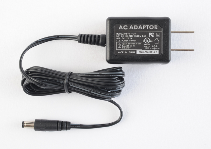

氣泵變壓器一問
各位CHING,小弟剛買了架仔氣泵。望見個火牛頭都大埋。請問有冇CHING 可以解答下我應該要買咩變壓器,同埋有咩要注意呢? 謝謝。

輸出直流12V,電流1A已上

No, get the 240V to 110V transformer.  Or easier option is buy the new AC adaptor with 240V input and 12V, 1A output.

for the second option, pls check if the circular jet's (the plug to plug into the bump) size are the same as your original and the +ve / -ve assignment of the jet are the same; there are some multi-purpose power transformer in the market which provide jets of different sizes and also with the +ve / -ve assignment alterable.

唔明白您想問乜野, 您買個日本泵, 見到個火牛頭為乜大左?? 佢有跟火牛既話, 如果電壓系110V, 買隻 220V轉110V既Step-down transformer 就可以, 無跟既話, 望下說明書個 規格,跟住去買就得
如果您post —相中就系隻火牛就去買隻 step-down 火牛啦,最簡單又 fool-proof

DC 12V 1A好簡單容易配, 去鴨寮街電子零件舖, 揾一隻萬用牛就得, 一般牌子就 winstar , 可調輸出電壓, 同附帶好多唔插頭
㗎仔都幾縮骨喎, 呢啲普通DC牛, 香港一般會比隻輸入 110V-220V 通用牛, 唔係乜嘢新科技, 有咗N年

樓主都無講佢邊度用, 可能佢住日本呢? (講下笑姐~XD)
樓主千其唔好插電, 否則件野可以bye bye了.
如上面幾位師兄講, 一係買個220V轉110V火牛.
又或是直接買個220V轉12Vdc, 1A就OK. 去SSP大把, 放心~
