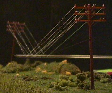

有這種線EZ Line,但在香港找不到。
http://www.berkshirejunction.com/scenery.htm
你搵到請通知聲我吧。

原帖由 nano 於 2012-3-30 10:52 PM 發表
你搵到請通知聲我吧。
CHing you made my day, this is a new thing to me ! Great ! May be we could group together and buy some.
