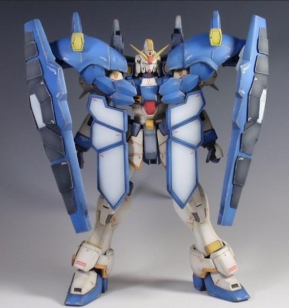

okakat_oasam's MG Sandrock 沙模鋼彈
http://schorst.blogspot.com/2012/03/okakatoasams-mg-sandrock.html
