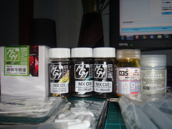

剛剛去拎上網訂ga野
MGM D油真係細到 ...
