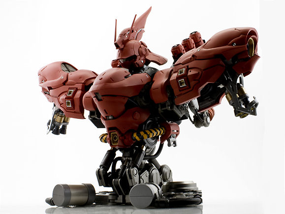

Can anyone tell me what kind of paint to do 滲線 for the Sazabi 半身像?  I don't know what kind of thinner will dissolve the original paint.  I am from Canada where no X20 is available.

冇x20麻煩少少
可以去文具鋪買水性筆畫線
再用火機油抹

I think there are a lot of hobby stores that carry Tamiya paint/thinner in Canada. I am not sure where exactly you are living in but I am sure you can get online as well.
If you are not re-painting the whole thing and leave the "PLA" look, I guess you just use the gundam marker... the scale is about 1/48 and I believe the marker will not appear too thick. use the grey color not the black.
by the way, that kit is in semi gross (clsoe to matt) finish and it will make it difficult to clean up the panel lines if you really want to do wash on pinal lines.

CA 去michaels應該有testor 顏料賣.
都係enamel.效果會好過tamiya.
但係佢隻enamel thinner會溶水性油,油性就唔會ge.
所以滲之前要試下會唔會溶左層底油.

Looking for substitute for X20??
why not go to Canadian tires or your favorite hardware store and ask for thinner for enamel paint. Sure they will be happy to help. I bought 1L of something called "paint thinner" back while I was living there 20yrs ago.
You can always us artist grade mineral spirit or turpertine from art supply store, but that could be costly.
