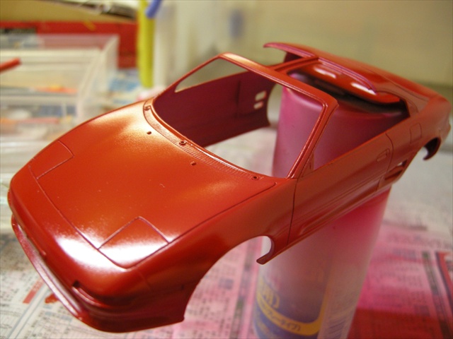

¼Q¨®
¸Õ¹L4,5¬[¨®, ¼Q¨Ó¼Q¥h³£¦n¾c, ¨F¯ÈËݼË(¨£¹Ï)
1) ¥Îfinisher ©ÎGAIA
2) ªo1¥÷, thinner¨â¥÷
3) ªì®ÉÂ÷4-5¦T, ¨£«YËݦAªñd
4) °£«D¼Q¨ì¦nÀã, §_«h³£«YËÝ, ­n¥Î¥úªo¼Q¨ì¦n«p¦A¿i
¦³§_advise ar?

¤@¯ë¼Q¨®³£«Y¼Q§¹¦A¿i,¦nÃø¸Ü§Y¨è¦¬¤u

§ÚºD©óthinner 3¥÷/4¥÷
¨ä¹ê«Y¼Q¨ì¤Ö¤Ö¿i¬â feel ¥ý«Y¬[Ø{¡A§A¼Q©³ªo¤w¸g¦n¥O¦P¦n¦ü¥úªoËÝ·Æ´N¤w¸g¤Ó«p³â

For Finishers, you need much more THINNER. You may need to double up your Thinner

­ì©«¥Ñ att5002 ©ó 2009-5-21 10:24 AM µoªí
¦³§_advise ar?
thks
¨ä¹ê¼Q¨®«Y­nÁ¿¨D©Ò¿×¡u·Æ²b¡v¡A¼Q¦â­nºÉ¶q¥­·Æ¡B¤Ö°_¨F¡A¥ý¦Ü¦³²z·Q®ÄªG¡A²³æ啲Á¿¡A°ò¥»¦â­n¨D¥i¥HµLËÝÄY®æ¡A¥u­n¦â±m§¡¤Ã¥­¾ã´N¥i¥H¡A­«ÂI¤Ï¦Ó«Y¤W¥úªo¡A¤@©w­n°÷¥ú°÷·Æ¡A¼Q¶î­nÂI«Y­n©Ò¿×¡uÀã¼Q¡v¡A§Y«Y¼Qªo¶q·|¤ñ¥­®É­«¡A¤Wªo·|¸û¬°­@°®¡A§Þ¥©´x´¤¤ñ¤@¯ë¼Q¦âÃø¡A®e©ö¬y²´²\©Îøu¹Ð¡A¤Wªo¤âªk­n¦³¦¸§Ç¡B¶¶ºZ¡B¦PµLªð¤â¡A®ÄªG¦ÛµM·|¸û²z·Q¡C¦Ü©ó¥´¿i¡A«Y³Ì«áûH­×¹¢¤u§@¡A¥i¥H­×¸É¤@啲­ø°÷·Æ²bûH¦a¤è¦P©ß±o¨®¨­§ó¥ú«G¡C¦ý­Ó¤H»{¬°¡A¼Qªo¨BÆJ°µ±o¦n¥ý¦Ü³Ì­«­n¡A¤Ï¦ÓÉn¿i¤u§@¥u«YÀA¤W²Kªá¦Ó¤w¡A±¡ªp§Y«Y¦P¤@­Ó¤k¤H­ø¤ÆùÛ§A³£Ä±±oè°¡A¦P¤@­Ó¤k¤H­n«l¤ÆùÛ§A¥ýı±oÊ\è°ûH¹D²z¤@¼Ë¡A­n¦³¦nûH©³½è¡A¥ý¦Ü·|¦³¦nûH®ÄªG¡A¥H¤W¯ÂÄÝ­Ó¤H·N¨£~~~~ ¡I¡I¡I
¦Ü©ó»Õ¤U±¡ªp¡A³Ì¤j°ÝÃD«YªoûH´§µo®É¶¡¤Óµu¤Ó§Ö¡A¥O¼Qªo®É¡Aªo¥¼¨ì¼Ò«¬ªí­±¤W¤w°®²U¡A§Î¦¨©Ò¿×°_¨F°ÝÃD¡A¸Õ¦b¶}ªo®É¥[¤JºC°®¾¯©ÎºC°® thinner¡A§ïµ½ªoº£¤Ó§Ö°®±¡ªp¡A°ÝÃD´N·|¦³©Ò§ïµ½~~~~ ¡I¡I

§Ú·Qª¾¦h¤Ö¤Ö¼Q¥úªo¬Jskill¡A¦]¬°§Ú¤@ª½¼Q¥úªo³£«Y°á¦í¤@ª½¼Q¨ì°÷«p´N¥´¿i¡A±q¨Ó³£µL¬ã¨s
ÂI¼Ë¥ý¯à°÷°µ¨ì°÷¥ú°÷·Æ ?
¦P®I­ø¦n¤Ï¤â¡A§Y«Y­n¤@­P©Ê¦V¤@­Ó¤è¦V¼Q ?

¨ä¹ê­ø«Y¸Ü·Q¼Q§¹§Y¨è¦¬¤u, ¦ýËݨF­±­n¼Q¦n«p¥úªo­øè°lor
i will try to use more thinner, but 1:2 i feel that it's already very thin..........
Ëݵ¥§Ú¸Õ¸ÕºC°®¾¯, by the way, finisher ¦³ÉNºC°®¾¯?

§A¥Î0.5µ§¼Q ? §Ú¥Î0.3µ§¼Q¡K1:2 «Y­ø¦h¼Q±o¥X¡A¤Ö¤Ökickkick¤UËÝ
§Ú¶}°p¤óªo³£·|¶}1:4 ¥ýı±o°÷smooth¡A¦P®I©O­Ó¤ñ¨Ò§Úı±o©ö control d¡A¤£½×«pÁ¡¦P§¡¤Ã³£©öcontrolÂI

§Ú³£«Y´NËݼQ Finishers, no problem at all.
¸ò¥»³£­øÃö [ºC°®¾¯] ¨Æ, ³£¸Ü§A¸¨­ø°÷ Thinner §r

Ú»ªð§Ad post §Ú³£«Y¸Õ¸Õ1:3 or 1:4 ¥ý°Õ, thks
btw, §Ú³£«Y¥Î0.3µ§¼Q,

¥Îlevelling thinner©ÎT-06/07 ¥i¯à·|¦³À°§U~!

okok, ¤µ±ß§Y¸Õ, thks

For COLOR paint, you may want to add a little bit more Thinner. In general, more thinner, better surfacer. However, more thinner, more layers have to be applied. I think 4 to 5 part of Thinner with 1 part of Finishers paint is OK.
For Glossy coat, this is another story. If there is more thinner added, the initial finishing is smooth. However, the Clear Coat paint would CONTRACT "¦¬¤ô". More Thinner, more serious problem and it could take couple days to a year. Unfortunately, if there is not sufficient Thinner, it would be hard to apply and the finiishing would be very rough. So, you have to find the BALANCE for this issue. Different Clear Coat may need a Different Balance Point. This will take some time to stuudy. Good Luck !

®e§Ú´¡¥y©C¥ý. ·Q°Ý°Ý¦U¦ì¤j­ô«Y¥Î´X¦hbar ¬JÀ£¤O¬J©O???
¸ô¹L¬J«p¦h¤h

0.35 Nozzle, around 2 to 3 bars

³£´X¤jÀ£Ø{.
ËݤjÀ£, ËÝ­nÂ÷´X»·¼Qdªo¥ý­ø·|¼u¨«§r?? sorry. °µ¥ª°ÝÃD«C¦~²K

§Ú­ÓpumpÉN¿ö, "Às统"d°Ý, ¤jÀ£¦n©w²Ó¦n(¹ï¨F­±°ÝÃD嚟Á¿)
§Ú´N¤j¤j²Ó²Ó³£¸Õ¹L, ÉNÉA¤À§O, thks

­nºCºC¸Õ, 2 bars ­ø«Y¦n¤j

¼Q¨®¬J­±¿n¤ñ¨ä¹ê³¥³£¤j
¦Ó¥B­n«YËݤj­±¿n¤W­n°µ¨ìªo­ø·|²`²L¦â¡A¢±­Ó¢ê¢é¢ú­ø¤j¬[³â
¦pªG¥Î¢°­Ó¢ê¢é¢ú¡A¼Q¤@¤é³£­øª¾¼Q­ø¼Q±o¦¨¤@­Ó¨®¨­
