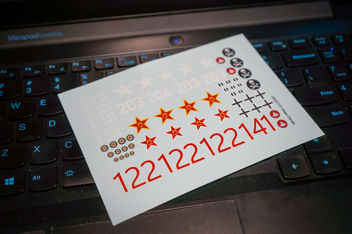

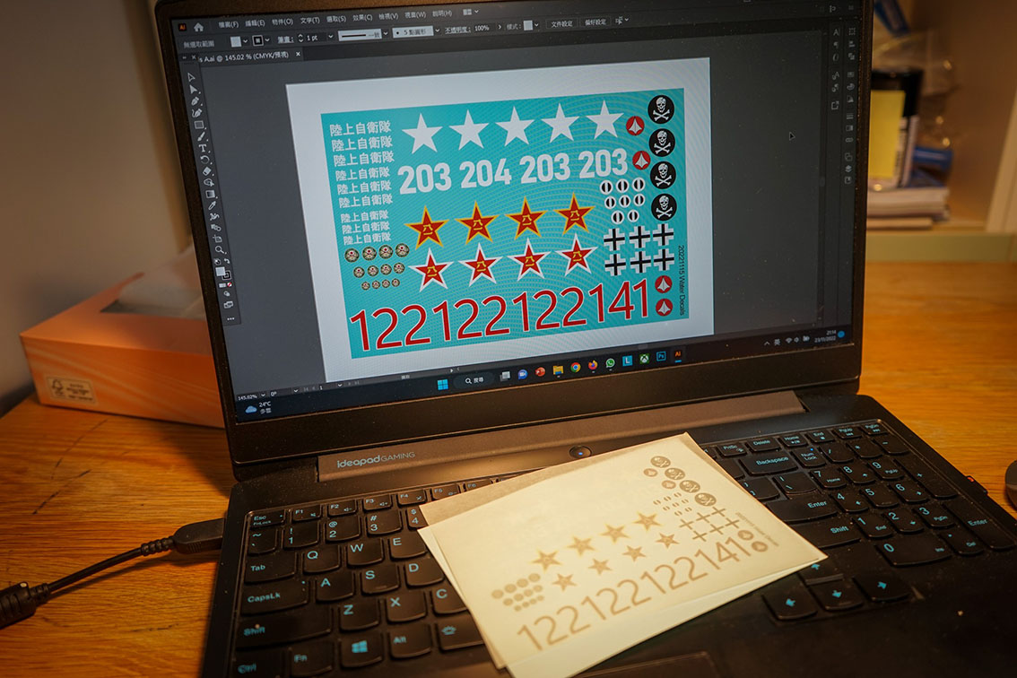

I use Adobe Illustrator draw a new file and send to China factory for production~~
