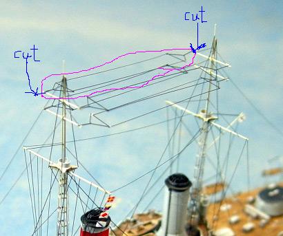

艦船拉線問題~
請問有無師兄知圖中三角位係拉線定蝕刻片?
如果係拉線點做出黎? 謝謝指教

應該係拉線做出來的, 呢個係好問題~~ 我都想問人好耐~~

This is also what I want to know for so long. I have no problem making the thin lines by stretching molten plastic. The difficult part is how to glue them. Because it is very thin, cement/glue will dissolve the thin plastic lines.  Hope there is an expert here who would share with us the technique.

我諗.... 係先在工作台上面,  拉好哂線, 切成適當長度, 用 aa 膠先痴好哂 三角 Y 型 ,  再用尖咀鉗 鉗住痴上攔杆, 最後先痴左右二邊線

用 aa 膠先痴好哂
If it is PE line, it is okay. For stretched thin plastic lines, I think "AA glue" would be too strong.

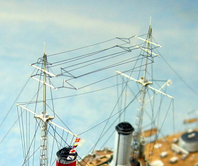

三角形應該係先做冇疑問~~  但要拉埋兩個三角形一頭一尾的兩條平衡線, 就會有些難度, 密斯兄貼的圖例係高手的效果, 佢可以拉線(平衡線)拉得好衡, 而首尾的三角形又冇走位~~
因為我都有砌船, 這類拉線的方式, 感覺上比較有難度

睇圖我都估應係拉膠絲出黎....就算俾我整到個三角形, 但點樣可以好似圖入面拉得"行"既情況下痴埋就諗唔到...
相信有砌船既師兄知我講咩

For 1/144 I used silk thread which gives perfect result. However, for 1/350 and 1/700, silk thread would be still too thick. Stretching molten plastic should be the only acceptable method.

咁得唔得
在工作檯上面,  先痴好哂 Y 的頭尾&左右二面  ( 藍色箭位係予返長少少),  用gel type aa膠  , 用牙簽點落欄杆, 放上去,
左手輕力按住一面, 右手慢慢扯行, 因 gel type aa膠 有多幾秒時間乾,   一路用口吹乾 ,  最後用鋒利模型刀 cut 走多餘的頭尾線

我會先將全組做好,一端預長D。 乾後將短那一端用「杰」小小既田宮膠水黏上桅杆,hold半分鐘等穩固了,再將長D 個一端拉去另一邊既桅杆,輕輕搭上橫杆上面,用田宮綠蓋膠力點上接合處,加小小力向下拉、hold住,等田宮膠水自動融斷膠絲。

道聽塗說:先粘好膠絲,再以點着的香烘一烘讓膠絲收縮,就可拉"行"了!

好耐之前問過啲船佬,
佢地話吉幾(6)口大頭針落 graph-paper 樹做定位點, 然後黐膠絲做個 frame , 乾後成抽嘢黐落桅杆樹.....
just like ...
     x             x
x                      x
     x             x
