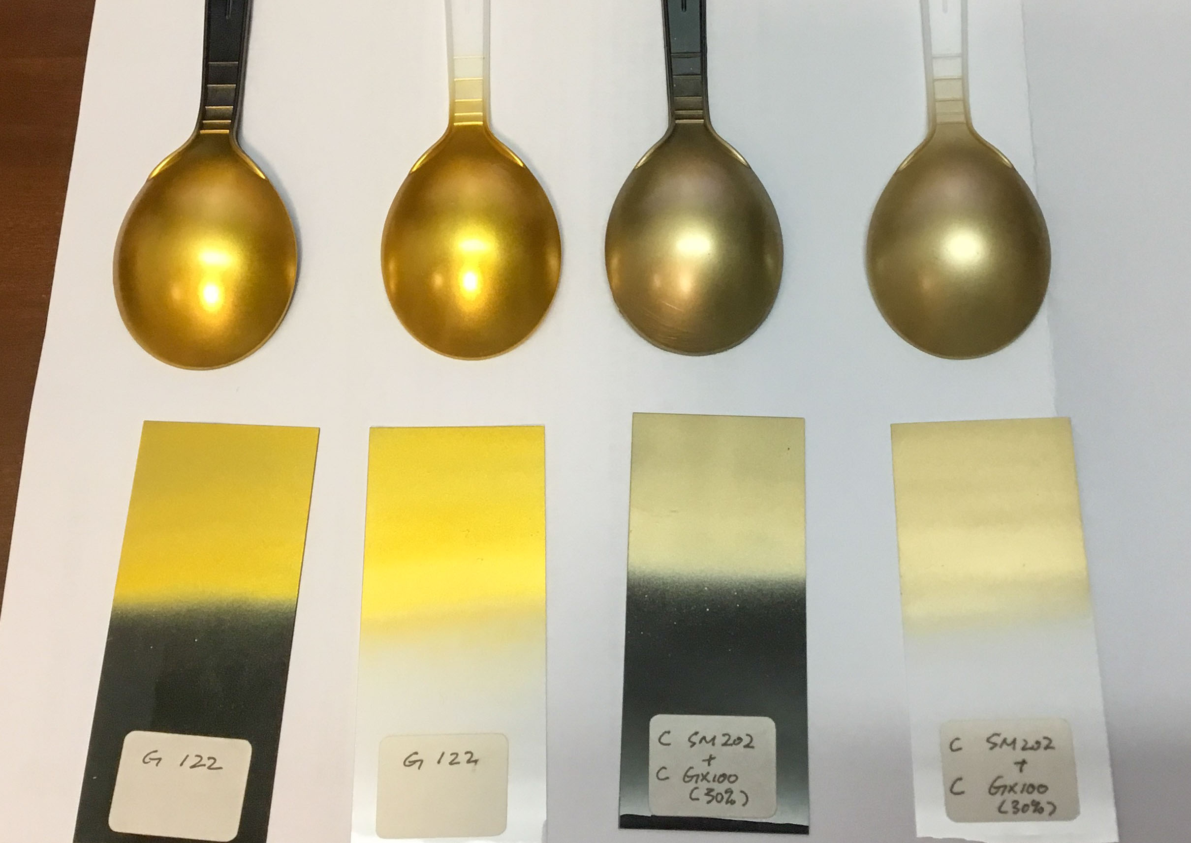

¤Q¸U­Ó¬°¤°»ò.....
§Ú¤@ª½·Q«Ø¥ß¦Û¤vªºÃC¦â®w.
­º¥ý§Ú¥²»Ý©Ó»{§Ú¹ïÃC¦âªºÂàÅܤ£¦b¦æ.  §Y«Y·¾¦â¹ï§Ú¨ÓÁ¿«Y¼²±m.  ©Ò¥H³Ì¦n³£«Y¦³²{¦¨ªº¦â.
©ó¬O§Ú¶R¥ª¦n¦h°Í§ó¼Q.
¨ì¦³´X¤Q°¦«á, ¦³d®ö¶OªÅ¶¡, ©ó¬O«Y²^¥J¶R¥ª¸Õ¦â¥d¯È¼Q.  ¼Q¥X¨Ó§^«Y¦n±o, ©ó¬O¶RWave¥Xªº¸Õ¦â¥d, ±¡ªp¤@¼Ë.  ¦º¨H¨H.  §Ú¥H¬°«Y§÷®Æ°ÝÃD, ©ó¬O¤Wºô¶R½¦¤ù¼Q.
©_©Ç«Y§Ú¥´¾î¤@¦æ¤@¦æ¼Q, ¼Q§¹¦n¦ü¦³¤@¦æ¦æ²ª.§Ú¥H¬°¦Û¤v¼Q±o¥¼°÷, ¦A½¼Q¨ìªÖ©wº¡³£¤@¼Ë®ÄªG.
§Ú©ðµf¦P¤@¤äªo¼Q´ö°Í¦P±i½¦¤ù¤ñ....³ºµM´X©úÅ㪺§^¦P¦â....¤Ï¥ú«×¦]¬°´ö°Í¦³¦±­±, ¤Ï¥ú«×§ó¥[«Y©úÅã.  ³Ì­«­n«Y´ö°Í¤ñ¸û±µªñ«Y¼Ò¦¡¤Wªº®ÄªG.
§Ú¦n§^©ú¬°¤°»ò¼Q«Y½¦¤ù³£·|¦P¼Q´ö°Í¦³§^¦P¦â?  ¦³µL®v¥S¥i«ü±Ð¤U.

¦n¦hºØ­ì¦]:
1,  ´ö°Í¤ÓÁ¡¤S«Y¥Õ¦â·|¦³¤p¤p³z©ú
2, ¦p§A©Ò­z´ö°Í¬O©·­±, ¦âªO«Y¥­­±, ¤Ï¥ú¤è¦V³£§^¦P! §^¥i¥Hª½±µ¤ñ
3, ´ö°Í¤@¯ë³£¨t¥ú­±, ¦â¥dÀ³¸Ó«Y°×­±, ¤S§^¥i¥Hª½±µ¤ñ
­«¦³¦n¦h­ì¦], sorry ­nµf¤u, ©]±ß¦Aµª§A

­ì©«¥Ñ Fei_Fei ©ó 2021-1-5 07:56 AM µoªí
¦n¦hºØ­ì¦]:
­«¦³¦n¦h­ì¦], sorry ­nµf¤u,  ...
®v¥S¡A­º¥ý¦hÁ¦^ÂСC
1.  ´ö°Í¨ä¹êµw¨­d, ·Pı¤W§^Á¡¡A½¦¤ù¤Ï¦Ó0.3mm¡A¬J«Y¤@­ÓA4 ½¦fileªº«p«×¡C½¦¤ùÀ³¸ÓÁ¡d
2.  §Y¨Ï©·«×§^¦P¡A§Ú¥Î½¦¤ù¶K®I°¦°ÍÚ»¡A¤@¼Ë§^¦P¦â
3.  §Ú¯Sµn¶R¥ú­±½¦¤ùªº¡C
§Æ±æ«ü±Ð¡C·Qݯ¤@­Ó¸Ñ¨M¤è®×¥ý¦A¼Q¦âª©¡A¤£°±¬~ºj¦n·Ð¤U...

¦^´_ #1 ngszewai ªº©«¤l
check the most gloss point on spoon, almost same color as per plastic sheet.
i think is the light reflection issue.
plastic sheet is flat surface, so all the light is reflected in parallel;
spoon is curve surface, so the light reflected in different angles.
i.e. colors are the light particles receive from eye, not the color on material.
therefore, the color feels different, but no difference.

µoªí©ó 2021-1-5 12:05 PM  ¸ê®Æ  µu®ø®§  ¥[¬°¦n¤Í
§Úı±o³Ì¤j­ì¦]«Y©·­±¼vÅT¦â¿Aªí²{......
¥H«e¾Ç¼Qµe¡A¦Ñ®v¦³Á¿¹L¦b¤j¥­­±­n¼Q±o§¡¤Ã«Y¦n§xÃø......
²{¹ê¤¤...¯S§O«Y¾÷±ñ¤H¼Ò«¬Ãä·|¦³¦âÍü¤WËݤjûH¥­­±¡A©Ò¥H¥Î½¦°Í¸Õ¦â§ó¶Kªñ¯u¹ê®ÄªG¡C

Ai..... §ó§ó¦n¡¨side¡¨¦ìma

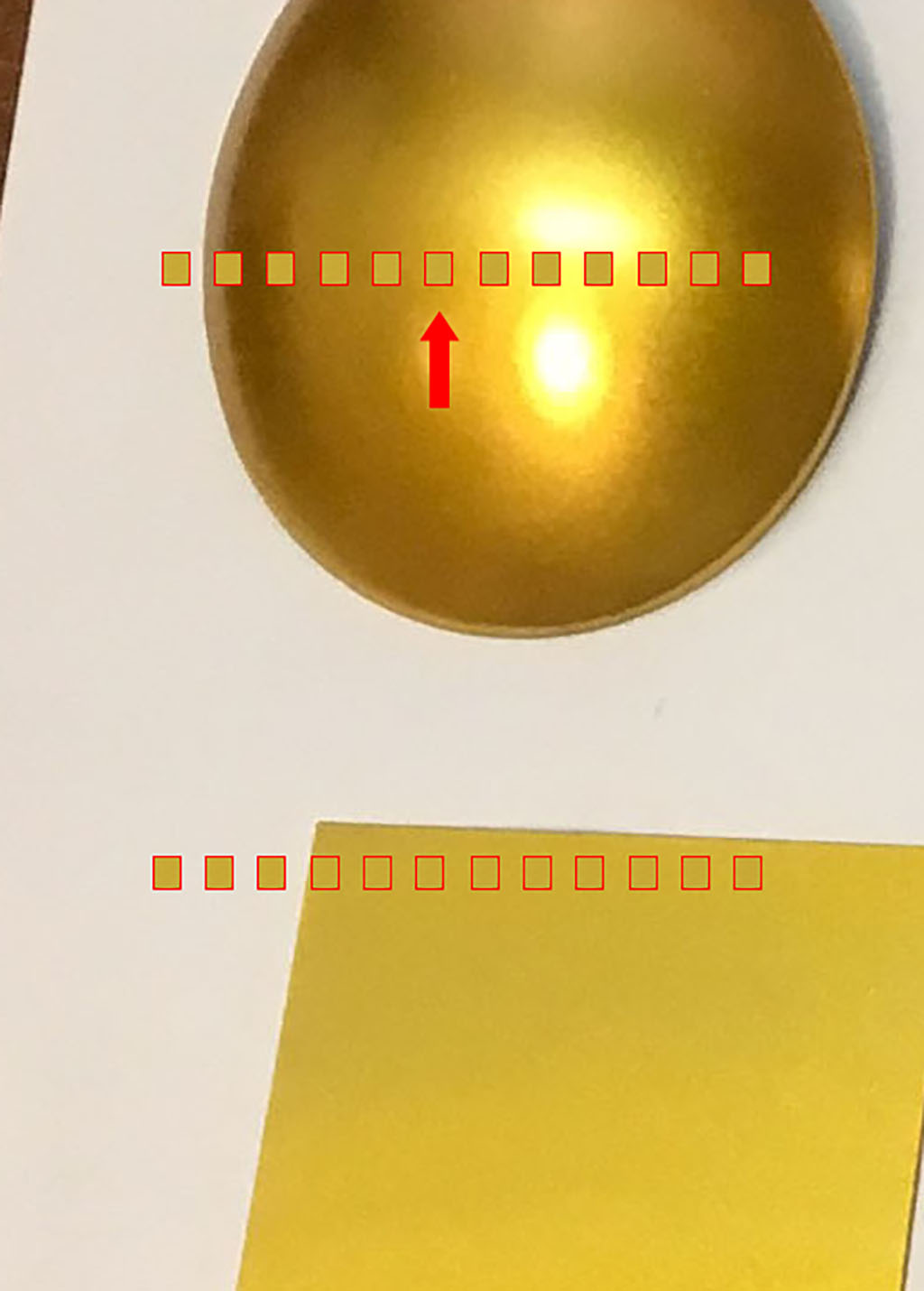

¨å«¬ µøÄ±/ÃC¦â¿ùı. color illusion
¬õ®Ø³£«Y¦P¤@¨Ó¨­¤U­±½¦¤ù¬J¤@­Ó¦ì. ©ñ®I¤W¥h°¦°Í¨ì´N·|¨£¨ì¨ä¹ê«Y¦³¤@­Ó¦ì«Y¦P¼Ë¦â¬J.

Ai....§Y¨ÏÃÒ¹ê¤F«YµøÄ±ªº¿ù»~¡A¼Q°Í§ó«Y·Q揾¦X¤ß¤ôªº¦â¡A¬JµM¯u¹ê¼Ò«¬¦P°Íü³Ì¦ü¡AËݦâªO¥u¦³¥Îµf°Í§ó

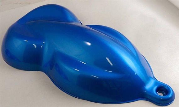

¦]¬°¥ú½u¤Ï®g·|¼vÅTµøÄ±¤WÚ»¨ì¬J¦â, ©Ò¥H¥Î¨Óªo¥ßÅ骫«~¬J¦âªO¦n¦h®É«Y¥Î°Í©ÎªÌ©OºØ¦n¦ü¤@¬[¨®¬J½¦´ß, ¤×¨ä«Yª÷Äݦâ. ©OÃþ´ß¦³¥­­±¤S¦³¦±­±, ©Ò¥H¤ñ°Í´N¦n.

¦L¨ê«~³q±`«Y¥­­±, ©Ò¥HÊ\¦a¬J¦âªO­ø¬~­n¥Î¥ßÅé¬J.

¦^´_ #3 ngszewai ªº©«¤l
¨ä¹ê§Ú«üªº¤Ï¥ú¤è¦V¬O«ü©·­±¬O¦V¤£¦P¤è¦V¤Ï¥ú, ©Ò¥H¥X¾¤·|¦³©úÅ㪺¥ú·t¦ì, ¦ý½¦¤ù¬O¥­­±¤Ï¥ú¤è¦V¤@­P, ¦³¥ú·t¦ì³£¨t¥ú·½°µ¦¨ªº, ¨Ì¼Ë²{¶H©úÅã·|¼vÅTÃC¦â¤Ï®g¤J²´ªº®ÄªG
¦Ó«pÁ¡, ¥ú°×´N¥i¯à¯u¨t¦p®v¥S©Ò­z§a, ¤£¹LÁ¡¤£¤@©w³z«×°ª, ¦]¬°¦nÚ»½¦®Æ¥[¤°»òÃþ«¬ªº¦â¯», ¦³D¥Õ¦â¦â¯»ªº³z¥ú«×¥i¥H¦n§C, ¥ÎüL¿O¥ú¤U¹ï¤ñ´N¥i¥H¬Ý¥X¹ê»Ú®t²§
