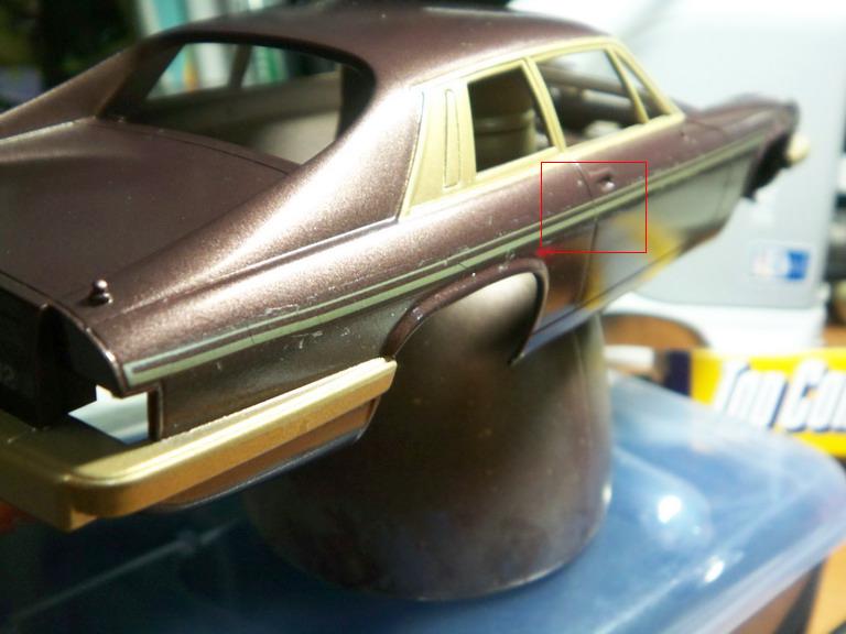

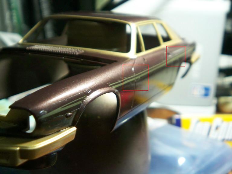

水貼遇上坑~~~點算???
扒文d師兄話可以用MARK SOFTER
係唔係一'茶'就會慢慢沉落條坑度???
我都有"茶"GA,但係張水貼都係咁堅挺
定係我支野過左期(支野用過一次,放左5年,上次既效果唔記得左,大耐啦)
我呢幾次都係CUT斷佢算

原帖由 johnnykut 於 2008-7-18 02:44 AM 發表
係唔係一'茶'就會慢慢沉落條坑度???
我都有"茶"GA,但係張水貼都係咁堅挺
我呢幾次都係CUT斷佢算
有冇相可以睇下

我通常會係個坑位cat一刀, 等d水貼入到去~~

i just use setter, can solve the prolem
after using it, wait for a moment 會慢慢沉落條坑

原帖由 Raybirg NSX 於 2008-7-18 03:48 AM 發表
有冇相可以睇下
就係呢幾個位啦~~
如果我第時想砌D落場車,我應該點算(成車都係水貼)
我支SOFTER會唔會過左期???

原帖由 MineSky 於 2008-7-18 10:28 AM 發表
咁講其實SETTER仲好用過SOFTER囉??

原帖由 johnnykut 於 2008-7-18 12:57 PM 發表
for my pt of view
you are right !~ setter can also make the decal softer and melt into 條坑
but may some other expert on model making may not think so

等水印乾了用𠝹刀記住要夠尖, 沿住坑cut 落去, 一定会断, 之後用softer 油上去再用棉棒壓入坑就ok, 冇softer 用火洒都ok, 再吾明參考本人的作品, 係冇點你

呢張圖係我未滲線同cut坑時影的
我就咁用setter,都做到溶落條坑既效果
當然最後為左像真,都要cut番開佢啦
