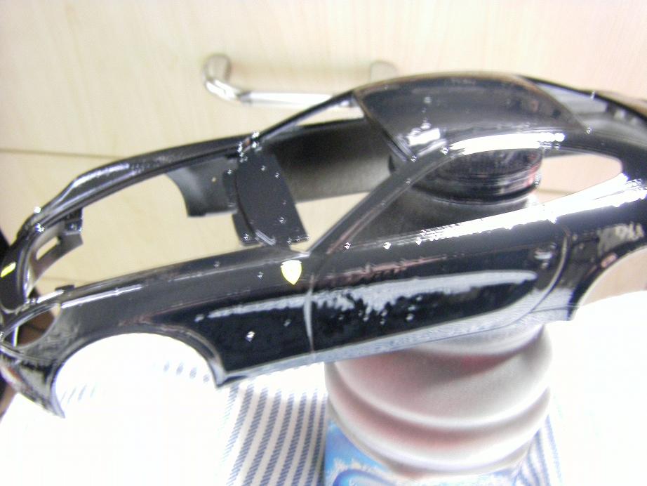

GP2ªº问题
请问¦U¦ìGP2 应该«ç¤\¥Î©O¡H¤µ¤Ñ¥ÎGP2喷§¹¦n¹³¦³¦n¦hÉaªw¡C¥H«e¥ÎGX100没见过¦¹类ªº±¡况°Ú¡C¨D¸Ñ¡C

­ì©«¥Ñ YTT ©ó 2009-3-30 11:51 PM µoªí
请问¦U¦ìGP2 应该«ç¤\¥Î©O¡H¤µ¤Ñ¥ÎGP2喷§¹¦n¹³¦³¦n¦hÉaªw¡C¥H«e¥ÎGX100没见过¦¹类ªº±¡úG°Ú¡C¨D¸Ñ¡C
GP2 ²V¦X/±µÄ² ¨ì ªo¥÷©Î¤ô¥÷.

µoªí©ó 2009-3-31 09:37 AM  ¸ê®Æ  µu®ø®§  ¥[¬°¦n¤Í
­ì©«¥Ñ DM ©ó 2009-3-31 02:11 AM µoªí
«Ü¦³¥i¯à¬O²V¤J¤ô¤À¤F¡C¡C¡C¡C车¬O68¤¸TAOBAO买ªº  还¦n¼K¼K¡C

µoªí©ó 2009-3-31 10:58 AM  ¸ê®Æ  µu®ø®§  ¥[¬°¦n¤Í
­ì©«¥Ñ YTT ©ó 2009-3-31 10:07 AM µoªí
谢谢¤j®a¡I
I have confirmed my answer since I have consulted expert and also done some experiment to prove it
By the way, whenever you have seen any bubble on the model, STOP IMMEDIATELY. For you current situation, it is almost no way to save

µoªí©ó 2009-3-31 11:09 AM  ¸ê®Æ  µu®ø®§  ¥[¬°¦n¤Í
¦ô­p§A«Y¼Q®É¦]¦³¤ô©Îªo¦Óµo²{¦³ªw¡Açܦí¼Q¦h¨â³¥µL¨Æ¡AÂIª¾¼Q·¥³£«YËÝ¡A¦¨³¡¨®´NÅÜ¥ª¤ô¨I¦Ó¥B¤@ÂÂÂÂ
gp2«Y­n¤´¦h´XÀò¥ý·|ÃѥΡA´Nºâ¼Q­ËµL³¥¡A¦]¬°ªoµw¡A©ß¥ú¥ç¤ñ¤@¯ëªoÃø¡A¦Ó®a³¡¨®À³¸Ócertified¡A¦]¬°gp2µL±o¬~

­ì©«¥Ñ DM ©ó 2009-3-31 11:28 AM µoªí
By the way, whenever you have seen any bubble on the model, STOP IMMEDIATELY. For you cur ...
Thanks.I can profit from your opinion!

µoªí©ó 2009-3-31 06:11 PM  ¸ê®Æ  µu®ø®§  ¥[¬°¦n¤Í
­ì©«¥Ñ wongleo ©ó 2009-3-31 11:09 AM µoªí
gp2«Y­n¤´¦h´XÀò¥ý·|ÃѥΡA´Nºâ¼Q­ËµL³¥¡A¦]¬°ªoµw¡A©ß¥ú¥ç¤ñ¤@¯ëªoÃø¡A¦Ó®a³¡¨®À³¸Ócertified¡A ...
§Ú¼Q²Ä¤@¬[µL¨Æ, ¤Ï¦Ó²Ä¤G¬[´N¥¤³¥........................¦º¦]¤@¼Ë......
¬~GP 2¥¼¦Ü©ó¬~­ø¨ì......¤£¹L«l·Ð, ¶R¹L¬[µLËÝìÐ......

µoªí©ó 2009-3-31 06:22 PM  ¸ê®Æ  µu®ø®§  ¥[¬°¦n¤Í
¦^´_ #1 YTT ªº©«¤l
¥i¥H¥Î¨è¤M.°Ò°Ò²£ªð¼hGP2¥úªo¥X¨Ó¦A¼Q¹L

µoªí©ó 2009-4-1 07:41 AM  ¸ê®Æ  µu®ø®§  ¥[¬°¦n¤Í
·|­ø·|ªñ±Æ啲¤Ñ®ð«l¼éÀã¡A嗰¬¦­Ó¤ô¹j¤S¨S¦³¤S©ÎªÌ¼Q±o¤Óªñ¡A¦]¬°¤Óªñ¤S½¤â¼Qªº®É¶¡­n´x´¤¡C
­Ó¤H·N¨£¡C
