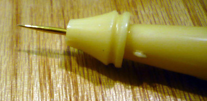

nope sure if this helps, but this is the needle that i use.... for flat surface can use ruler, for curve surface,i think its still better to use tape, although i have not much experience in it....
to be honest, i usually just use the needle to make the lines go deeper, only if i want to draw specific shapes, like circle, then i'll use a metal template, actually the needle comes with the metal template!

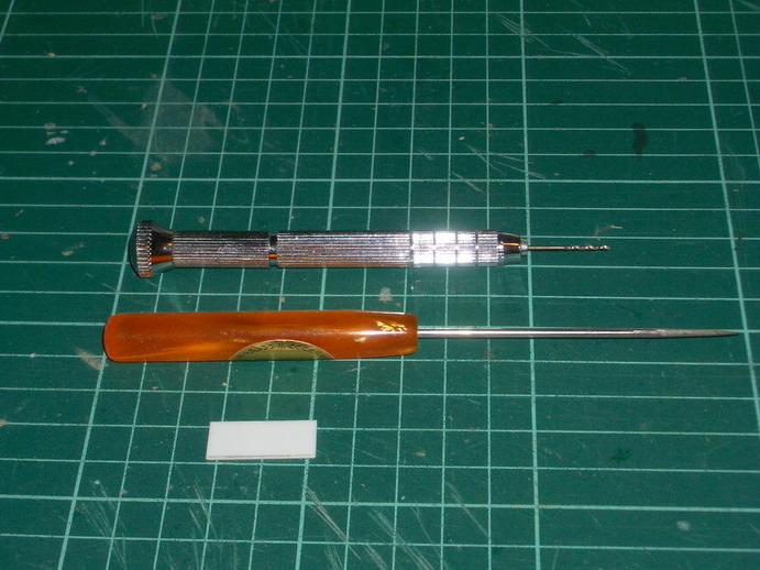

§Úªº¨è½u¤u¨ã, ²³æ¦Ó¥Bcheap.
