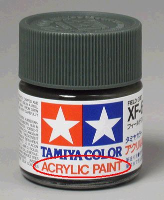

you can paint directly on the 電鍍 parts with Acrylic paint (水性油). Acrylic paint will not affect
the electroplated surface.
But airbrush is highly recommeded because the surfaces of electroplated parts are just little bit
slippy to paint with hand brush......

發表於 2007-5-28 06:44 PM  資料  短消息  加為好友
mr color paint (lacquer paint) is not recommended.
use tamiya acrylic
check ref
http://www.tamiya.com/english/products/list/acrylic_1.htm
