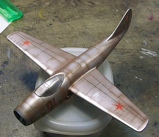

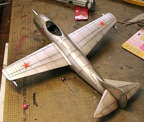

好稀咁薄噴都得架.......不過....一摸就甩囉....
....上次用o黎做鏽漬都唔錯丫......
